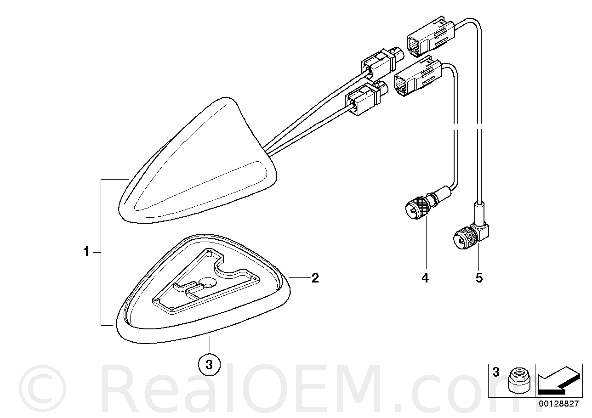

I've seen discussions about this over on NAM. Typically, the shark fin antenna is from another make/model vehicle and it's been grafted onto the MINI. Some of the problems were that the curve of the antenna base doesn't match the MINI roof and, the length of the antenna (especially if there's a sunroof involved) interferes with the rear hatch (for the R56 at least).
Keep in mind that there are other elements in play here. Catalina has the Factory NAV system and the OEM antenna isn't just a radio antenna, it also houses the SIRIUS and the GPS antenna for the NAV system. If you have more than just AM/FM radio, you are going to have to figure out a way to replace/incorporate those additional antennas into the new shark fin.
It might work to swap in a BMW antenna but then there's going to be the issue of the curvature of the base.
Nobody is making one of these for the MINI because it's going to be pretty darn expensive. Looking at the shark fin for the X5, the housing all by itself, no internals is over $150.00. Then you have to figure out if the guts of the current antenna will fit under it, have that done and then pay to have it properly mounted.... That's got the potential to be a $300+ mod just for aesthetics since it's not going to improve the performance of the associated systems.

BMW shark fin that goes on their 3 series might work. I've seen these on sale on ebay. . .do a search for "BMW Shark Fin OEM" to find the original working factory ones. . .might even be able to find one painted in your color.
Edit. . .i guess there are issues with the contour. You could re-contour the base but that could be tough getting it just right. As for the nav and everything else. . .are the guts still good in yours? You could swap the internals out/splice the wires. Guess the real question is how much fabrication do you want to do to get it right. And CMCVEAY is right, it's gonna cost.

I think it will come down to just how much $$ and time anyone wants to put into this kind of project. If it's just AM/FM, it's probably not too hard. Adding OEM NAV and/or SAT RADIO, it starts getting tougher. I checked the part number and all of the BMW M and X series with Shark Fins use different antennas so it doesn't look like the internals of their antenna would work. There's a chance that with some time and epoxy, the internals of the MINI antenna could be removed and attached inside the fin cover that has been recontoured to fit the MINI roof line. Chris, do you have NAV or SAT Radio?

If a vendor with a molding ability were interested, it actually wouldn't be too hard. They would be able to make the proper external dimensions to fit between the hatch and the sunroof, fit the contour of the roofline and then, internally, it would have the proper attachment point for the "guts" and the hardware to secure it to the roof.

Catalina has the factory NAV and her GPS antenna is in the OEM antenna base. With that, it means figuring out a way to stuff that gear inside the shark fin. Do you mean run the antenna wires outside the enclosure and down into the hatch? If so, I've gotta say that would be butt-ugly. They should go through the factory opening. I think this could be a fun project but it ain't gonna be easy!
